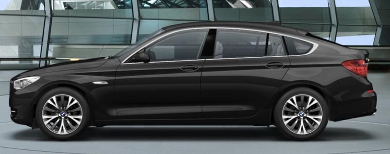

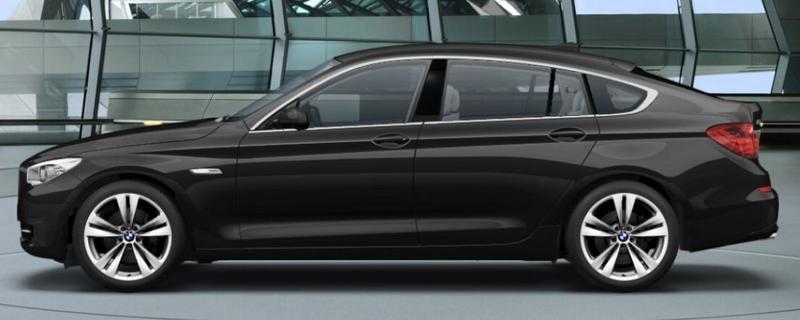

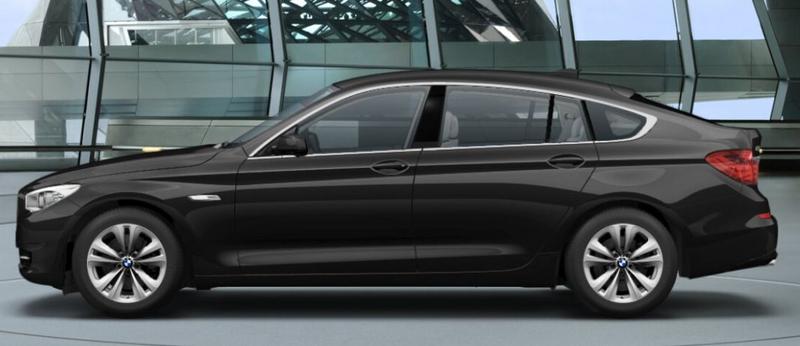

funki Posted May 13, 2013 Author Report Share Posted May 13, 2013 He sacado unos recortes del configurador de bmw, a ver que os parece. En 18(actual), en 19 y en 20. Quote Link to comment Share on other sites More sharing options...
funki Posted May 13, 2013 Author Report Share Posted May 13, 2013 Pues algo si quedaría la cosa.<p><a href="https://www.todoradares.com/foro/uploads/monthly_2013_05/56fd083343e2c_GT18.jpg.c8bab6997fa2499f6eaaba9f3a071223.jpg" class="ipsAttachLink ipsAttachLink_image"><img data-fileid="4243" src="https://www.todoradares.com/foro/uploads/monthly_2013_05/56fd083343e2c_GT18.jpg.c8bab6997fa2499f6eaaba9f3a071223.jpg" class="ipsImage ipsImage_thumbnailed" alt=""></a></p><p><a href="https://www.todoradares.com/foro/uploads/monthly_2013_05/56fd08335ad1d_GT19.jpg.eb005e0e2e8fd66ed840cf33124137e1.jpg" class="ipsAttachLink ipsAttachLink_image"><img data-fileid="4244" src="https://www.todoradares.com/foro/uploads/monthly_2013_05/56fd08335ad1d_GT19.jpg.eb005e0e2e8fd66ed840cf33124137e1.jpg" class="ipsImage ipsImage_thumbnailed" alt=""></a></p><p><a href="https://www.todoradares.com/foro/uploads/monthly_2013_05/56fd08336dc3f_GT20.jpg.edc6da5900ecabd7f0fbca2d7ce63054.jpg" class="ipsAttachLink ipsAttachLink_image"><img data-fileid="4245" src="https://www.todoradares.com/foro/uploads/monthly_2013_05/56fd08336dc3f_GT20.jpg.edc6da5900ecabd7f0fbca2d7ce63054.jpg" class="ipsImage ipsImage_thumbnailed" alt=""></a></p> Quote Link to comment Share on other sites More sharing options...
colmenedo Posted May 13, 2013 Report Share Posted May 13, 2013 He sacado unos recortes del configurador de bmw, a ver que os parece. En 18(actual), en 19 y en 20. Impresionante......echando numeros si eso no te importa las de 20" le quedan de cine. Saludos! Quote Link to comment Share on other sites More sharing options...
hectorlibra Posted May 13, 2013 Report Share Posted May 13, 2013 Cuidado con las ruedas runflat y los perfiles muy bajos, que un bache fuerte las daña fácil. Cuando tenía el Mini, cambié 2 por ese motivo. Quote Link to comment Share on other sites More sharing options...
funki Posted May 13, 2013 Author Report Share Posted May 13, 2013 Impresionante......echando numeros si eso no te importa las de 20" le quedan de cine.Saludos! A que no parecen tan exageradas colmenedo? La verdad que me están tentando esas llantas. Cuidado con las ruedas runflat y los perfiles muy bajos, que un bache fuerte las daña fácil.Cuando tenía el Mini, cambié 2 por ese motivo. Las pondré convencionales Hector, por eso quiero bajar el perfil, runflat creo que "nunca mais", xDD. Quote Link to comment Share on other sites More sharing options...
