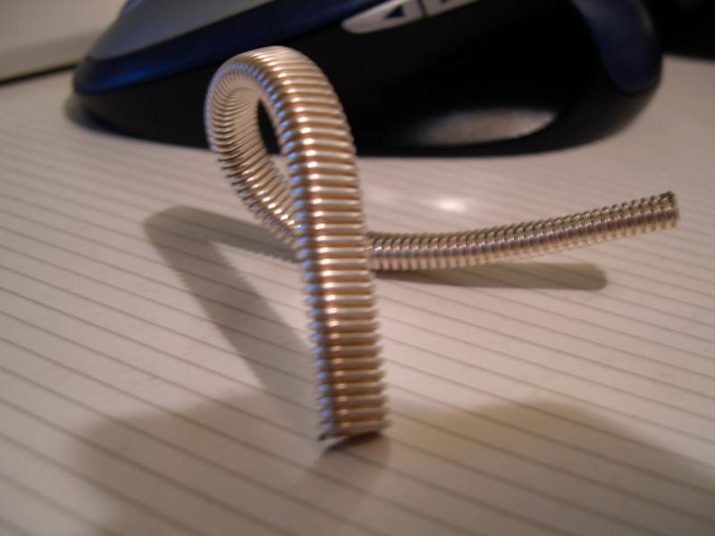

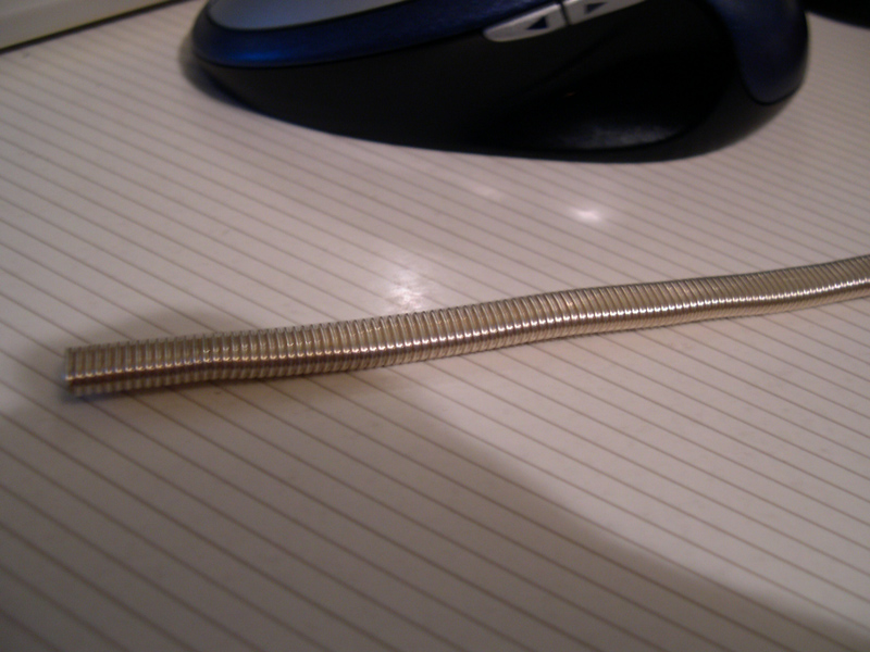

Walker Posted September 27, 2005 Author Report Posted September 27, 2005 ANIMO!!!!!! si quereis voy con el avituallamiento para que no os canseis y el trabajo salga redondo bueno estate mañana preparado, por si me puedo escaquear y empezar a montar. Ya tengo el guiaondas, fui esta mañana a por el, realizado en plata y ademas de flexible es maleable... una afoto:<p><a href="https://www.todoradares.com/foro/uploads/monthly_2005_09/DSCN2686a.jpg.7aaed66c3dcc7b6ae98a0cd3411013ca.jpg" class="ipsAttachLink ipsAttachLink_image"><img data-fileid="96" src="https://www.todoradares.com/foro/uploads/monthly_2005_09/DSCN2686a.jpg.7aaed66c3dcc7b6ae98a0cd3411013ca.jpg" class="ipsImage ipsImage_thumbnailed" alt=""></a></p> Quote

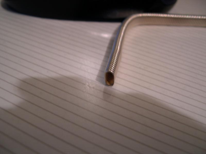

Walker Posted September 27, 2005 Author Report Posted September 27, 2005 se dobla:<p><a href="https://www.todoradares.com/foro/uploads/monthly_2005_09/DSCN2687a.jpg.7827d7babed0b33046f2553115bd155e.jpg" class="ipsAttachLink ipsAttachLink_image"><img data-fileid="97" src="https://www.todoradares.com/foro/uploads/monthly_2005_09/DSCN2687a.jpg.7827d7babed0b33046f2553115bd155e.jpg" class="ipsImage ipsImage_thumbnailed" alt=""></a></p> Quote
Walker Posted September 27, 2005 Author Report Posted September 27, 2005 y se redobla, imaginaos si funciona lo que podriamos hacer con el.... saludos walk<p><a href="https://www.todoradares.com/foro/uploads/monthly_2005_09/DSCN2688a.jpg.29456ec2fd44ab299d0fdc976df89541.jpg" class="ipsAttachLink ipsAttachLink_image"><img data-fileid="98" src="https://www.todoradares.com/foro/uploads/monthly_2005_09/DSCN2688a.jpg.29456ec2fd44ab299d0fdc976df89541.jpg" class="ipsImage ipsImage_thumbnailed" alt=""></a></p> Quote
